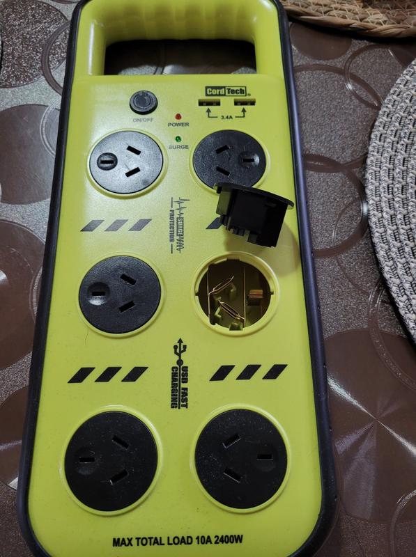

CordTech CPC4-W (see customer reviews on Bunnings' page)
Risk level: Medium–High
Fault:
Socket contacts can hardly be reached by the plug pins (causing pop-out), as the socket design fails to account for the casing thickness.
Alternatives: I'd generally go with a normal power-board and separate USB supply; however if you insist on a cubic combination device, the Jackson Power Block is a reasonable option (especially if you're prepared to recap and poly-mod it) albeit with only 2 ports (2.1A total).

CordTech 6WS34-TGH-PR (customer review was on Bunnings' page but that's gone; I hope it really is discontinued)
Risk level: High (tentative rating)
Faults: Weakly clipped-in socket faces which can pull out with the plug, exposing live contacts. Here's the customer review photo:
Shocking! (both literally and figuratively)
CordTech broken.jpeg (74.13 KiB) Viewed 38984 times
Replacement: I'd use a regular power-board and plug in a USB supply (to avoid creating extra waste when the supply fails).

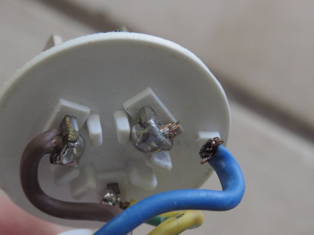

In Arlec's design (Australia), the wires break easily after a few turns due to a lack of internal strain-relief:
The sole attempt at internal strain relief was tucking the cores between those pairs of ridges. What were they thinking?!?
Arlec swivel plug failure.jpg (52.05 KiB) Viewed 68172 times
(There was an official recall of a certain run albeit for a different reason, but in reality all of them should have been.)
Another type found on Belkin power-strips in North America has a different construction (sliding contacts inside) but is also infamous (maybe more so!) for burning; here's an example report (among many).
Possible remedy: For the Arlec version (if you have some that haven't broken yet), you could glue them permanently into the orientation you use them in.
(Even then, I'm not so sure I'd trust them that much…)
For the Belkin version, I don't see any remedy other than replacing the plug (or the whole unit).

  • Allocacoc PowerCubes: In a better time I might have given them an actual recall; but since there's much worse available in this market (as mentioned above) and relatively few good options (Kaifeng KF‑MSD‑4A being the best I've seen) anyway, I'm pragmatically letting them go for now. I still strongly recommend that you either add a thermal fuse to the MOV or just remove the MOV altogether, though (better to end up with a dead PSU than a house fire).
    In Australia/NZ there's now a better-made local clone, Jackson Industries' Power Block (though I advise the non-USB version)… Actually, now that one of my non-USB Power Blocks had a failed solder joint on the end socket earth, I could technically count them here too; but since they're otherwise a winner, this is easier to fix than a broken cord grip, and the other two I bought pass, I'll again spare them the indignity of a recall.
  • Arlec SWP-LS series4 power-board: (and presumably related models such as SWP-S, FWP-S)
    Perhaps the first item here where a close call is an improvement from my expectation; on the back it warns to perform insulation testing at only 250V, which suggests MOVs from L to E and N to E (see the Loopholes/Low Standards post regarding the perils of those arrangements). On opening it up (with the needed exotic-but-obtainable triangular bit), however, it just has the one MOV from L to N; and there's no provision for others as an option (or even for a PCB big enough to hold them). It's still cheaply made though (as seems typical of Arlec products), with thin busbars (though still sufficient to pass 10A) and only a crude wire fuse for the MOV fail-safe, and the LED series resistor gets quite hot (not uncommon in these).

  • Sansai DB-793 nightlight: In the one I found, the active pin's mounting post broke allowing the pin to push into the PCB; luckily it only touches pads it's connected to anyway. They also omitted the bleed resistor for the 220nF X2 capacitor, the rectifier is rather strange (4×1N4007 but not in a true bridge, such that the negative half-cycle is shunted out and they could as well have used 2 diodes), the transistor has its collector and emitter reversed, and the soldering is quite bad (with a cold joint on the LED anode). Seems par for Sansai's course though…
